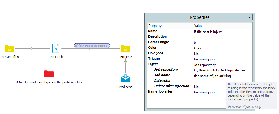

by flussidicaio
with the scripting module it would be easy.
without you can try with "inject job".
See the attached file
