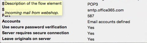

We just switched to Office365 and I'm having problems connecting to the mail server when receiving e-mail. Sending e-mail works perfectly.
This is the error I get in the messages window:
Failed to connect to mail server smtp.office365.com; error message: NTLM authentication: Timeout.; SASL DIGEST-MD5 authentication: Timeout.; CRAM-MD5 authentication: Timeout.; APOP authentication: Timeout.; SASL Plain authentication: Timeout.
Mail receive settings
Skärmavbild 2018-05-22 kl. 15.45.38.png (89.5 KiB) Viewed 34850 times
Any ideas as to what might be incorrect in my settings?
Solved.
The server name and port number were incorrect. Once I changed them everything started working as it should... :lol:

Hi LasseThid
check you incoming mail server setting "In the 'Incoming mail server' field type outlook.office365.com" and the port 995. i did not test this myself.

Yup, That's what I found in an e-mail our IT sent to me.
Once I changed the settings it all started working.
