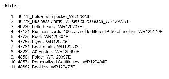

The use of <ol></ol> html tag does the trick ;)
what the Switch variable in the HTML mail looks like:
<ol><li>[Metadata.TextIndexed:Path="//info",Dataset="Mail",Model="XML",Separator="</li><li>"]</li></ol>
the result:
