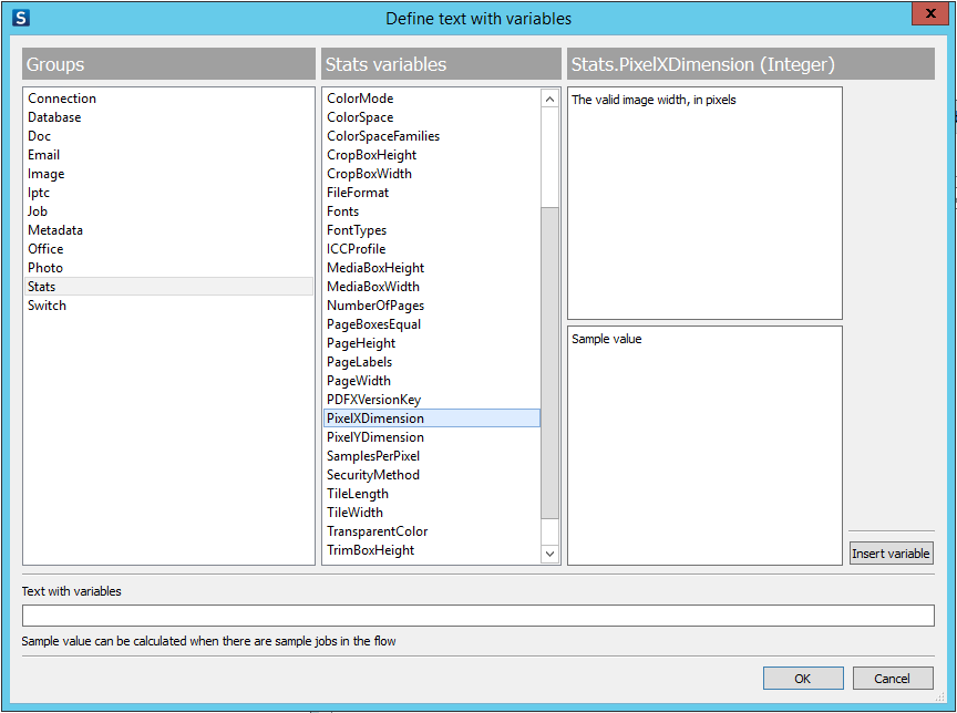

r.zegwaard
Posts: 104
Location: The Netherlands
Re: Sort images by landscape or square
Post by r.zegwaard »
HI,
You can compare the [Stats.PixelXDimension] with the [Stats.PixelYDimension]
If they are equal, it's square.
So make two connections with "Define condition with variables" to let only the wanted (square/landscape) files through.

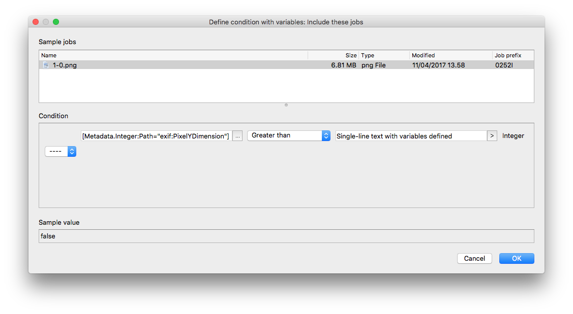

Terkelsen
Posts: 346
Post by Terkelsen »
Skærmbillede 2018-09-26 kl. 12.33.22.png (77.44 KiB) Viewed 8399 times
