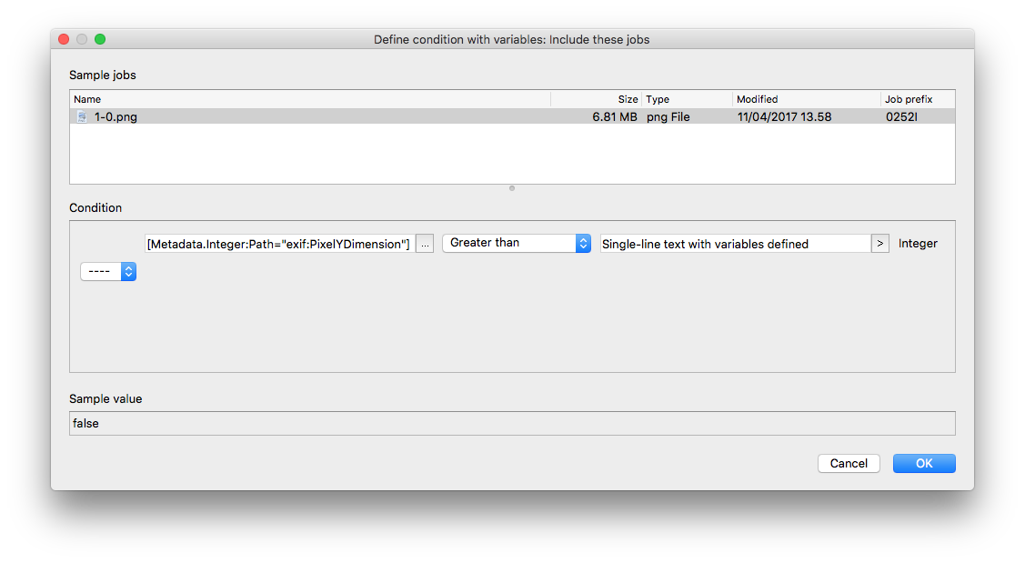

Re: Sort images by landscape or square
Posted: Wed Sep 26, 2018 12:34 pm
by Terkelsen
Skærmbillede 2018-09-26 kl. 12.33.22.png (77.44 KiB) Viewed 8404 times
Posted: Wed Sep 26, 2018 4:16 pm
by r.zegwaard
Here's a sample flow.
Posted: Wed Sep 26, 2018 6:03 pm
by tarek.bettaieb
Thank you :) it works :)
