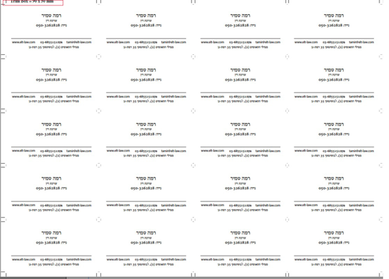

I have a 50 * 90 mm business card
And I want to duplicate it so that it goes into the page (through the "Quite imposing" plug-in).
After the duplication I created a new sheet with 20 tickets,
I want the top corner of the sheet to say "trim size"
So that the employee who cuts the cards knows what final size he needs to cut it.
How can I do it?
Quite Imposing is removing the art/bleed/trim boxes and setting the media/crop boxes to the new imposed size.
It's clear to me that I can always type manually.
but I'm looking for an automated script/action list
It is important to emphasize that each time the size of the card varies from work to work.
Attached file with the target.
Thanks!
Paste trim size after imposition of the size of orginal card
- aa.png (128.59 KiB) Viewed 17468 times
Re: Paste trim size after imposition of the size of orginal card
There might be a way to set in the template that you want the final trimsize printed on the template. But I don't know Quite Imposing, so I can't help with that.
A way you could do it is:`
Remember the trimbox dimensions of the incoming PDF in private data or the jobstate
Do the imposition
Use PitStop Server to place the text from private data or jobstate on the pdf. You can do this using the "Add object" Action and setting the text to be added via variables.
Do the imposition
Padawan's method should work fine.
If you want to do it with Quite Hot Imposing, you can be creative and first rename your file/page to add dimensions, than use "Stick on Text" in Quite Hot Imposing and pull field "File Name Short".
I hope this helps
I hope this helps
what i do is after quite hot impo is done run a action list "set trimbox to trim marks" then you can ad the text outside the trimbox.
