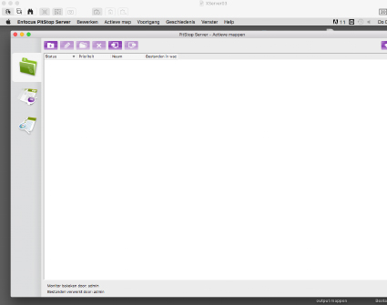

Is there anyone who can tell me if Pitstop Server works fine with macOS Mojave

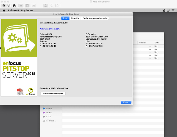

I have installed everything on a new mac and only get to see pitstop (see image)
While it should actually be like in image 2.
Pitstop Server and Mojave

Re: Pitstop Server and Mojave
It's not officially supported but it should work ok.
Make sure you have the latest OSX version as there were some issues with SMB shares in the first version.
I can't see clearly from the Screenshot, but did you deactivate the software on the old machine before moving it?
If not then the license server thinks it's still in use on the old mac.
If you drop our support a mail they will be able to help you.
