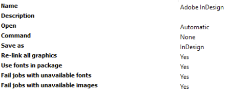

If you use Indesign to recreate the package it will list any missing fonts or images in the xml report.
Screenshot 2019-02-19 09.29.07.png (30.68 KiB) Viewed 11221 times

Sean IO
Posts: 18
Joined: Mon Dec 03, 2018 7:58 pm
Re: Flow for Preflighting InDesign files
Post by Sean IO »
Thanks Malcom,
Your suggestion seems more conventional. I had no idea you could repackage InDesign files from Switch. I will give it a spin and see what happens.
