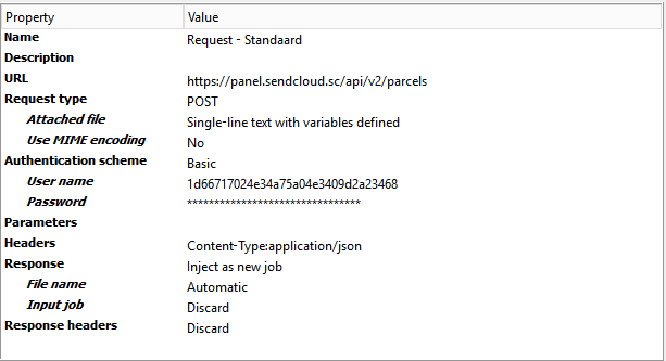

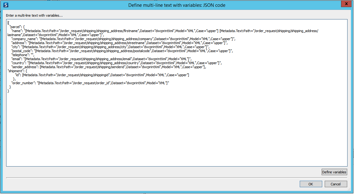

We use the app "Make JSON" and the POST function in Enfocus. I have add some screenshots.
The setting of the POST (HTTP reuest app)
Schermafbeelding 2019-02-27 om 17.18.41.png (24.73 KiB) Viewed 22980 times
The JSON of the app "Make JSON"
aa
aa
Schermafbeelding 2019-02-27 om 17.18.56.png (60.42 KiB) Viewed 22980 times

Now I’m thinking of it, try this header, might work:
Content-Type: application/json;charset=utf-8
Re: JSON with special characters
Posted: Thu Feb 28, 2019 12:32 pm
by mart3223
I don'y have the scripting module. I have tested with the header "Content-Type: application/json;charset=utf-8" but that doesn't change anything. Can it be a bug in Switch?
