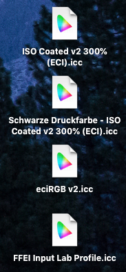

What ICC profile are you using. One of your own or a standard one that comes with PitStop?
I have never seen that error before.

Re: RGB to CMYK
We are a printing company and we use these profiles.
- Profil.png (155.54 KiB) Viewed 8017 times
