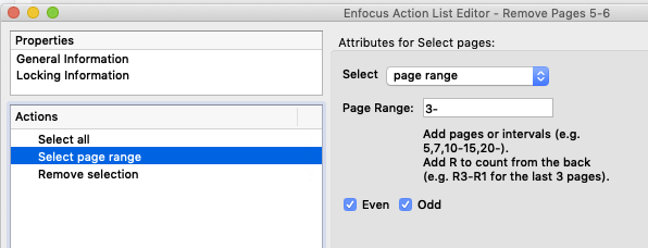

The report needs to go to another PitStop element and run a saved action as below
Screenshot 2019-03-09 09.22.20.png (36.46 KiB) Viewed 17024 times
