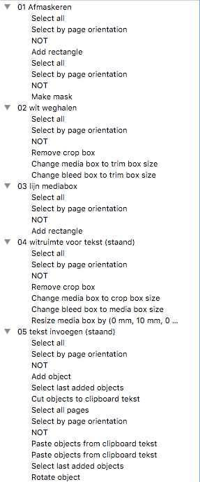

Robbie: I took the liberty to look at your action list and I think I understand what's going wrong for you.
Basically first you Select all and then Select pages by orientation, then in 01 Afmaskeren you again Select all. This means that everything in the pdf is selected, not just on the pages you selected in the beginning of the action list. The same thing happens in 02, 03, 04 and 05.
I modified your action list to be Select all, Select by page orientation Landscape and the added a NOT to deselect the landscape pages, then I added these two after every Select all in 01, 02, 03, 04 and 05. I then changed the second Select pages by orientation to Portrait and again added a NOT and inserted these two after every Select all in the second 01, 02, 03, 04 and 05.
I think this gives you the result you're looking for with one exception. The text on the landscape pages is not rotated correctly.
Perhaps Andrew can find something I missed? :lol:
By the way... I think you can delete the Select all, Select pages by orientation and NOT outside of the 01, 02, 03, 04 and 05 parts and still get the same result...

Unfortunately I cant save it as an older version, but what I did was to change the orientation in your Select pages by orientation from Portrait to Landscape and then add a NOT after that selection. i.e. the action list looks like this.
Select all (This selects all pages)
Select pages by orientation (Landscape instead of Portrait) (This selects all Landscape pages)
NOT (Removes Landscape pages from selection)
I did this everywhere where you have a Select all.
In the second repetition you select Portrait instead of Landscpe and do the same.
I hope it's ok I post a screenshot of the action list.

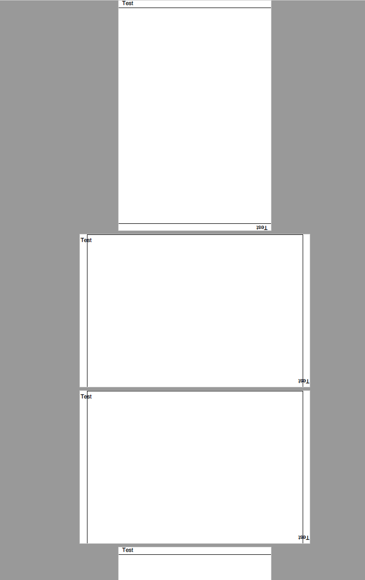

Can you try the attached Action List and Test file.
This increases the Media Box size by 20 mm as requested.
Can you test this and see if it does what you want.
You'll need to look at the Media and Trim Boxes.
The other boxes are not needed at the moment (if at all).
Once we get this part ok we can move onto the next part of the story.
