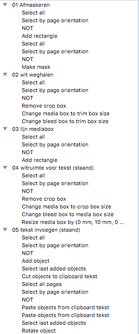

Robbie: I took the liberty to look at your action list and I think I understand what's going wrong for you.
Basically first you Select all and then Select pages by orientation, then in 01 Afmaskeren you again Select all. This means that everything in the pdf is selected, not just on the pages you selected in the beginning of the action list. The same thing happens in 02, 03, 04 and 05.
I modified your action list to be Select all, Select by page orientation Landscape and the added a NOT to deselect the landscape pages, then I added these two after every Select all in 01, 02, 03, 04 and 05. I then changed the second Select pages by orientation to Portrait and again added a NOT and inserted these two after every Select all in the second 01, 02, 03, 04 and 05.
I think this gives you the result you're looking for with one exception. The text on the landscape pages is not rotated correctly.
Perhaps Andrew can find something I missed? :lol:
By the way... I think you can delete the Select all, Select pages by orientation and NOT outside of the 01, 02, 03, 04 and 05 parts and still get the same result...

I hope it's ok I post a screenshot of the action list.
Skärmavbild 2019-04-09 kl. 16.02.01.png (70.07 KiB) Viewed 30721 times

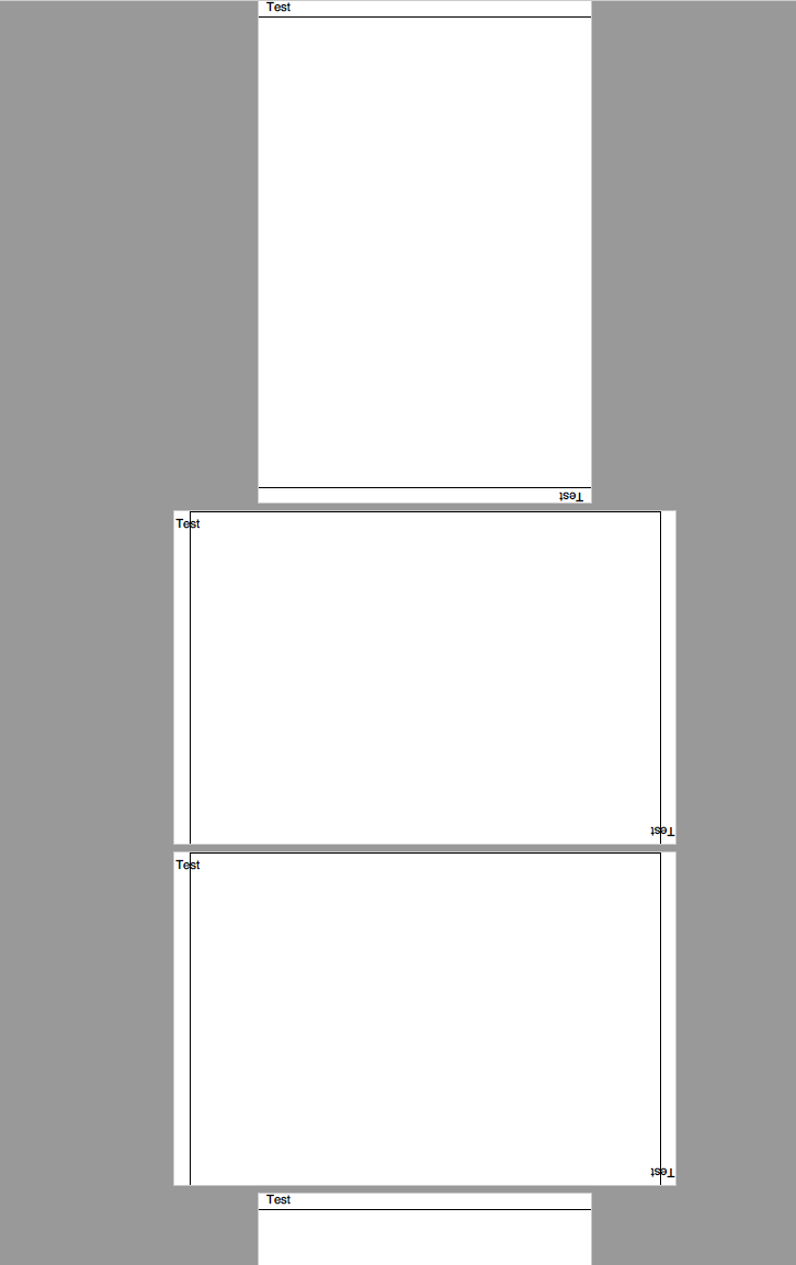

Thanks it works nice. i made some small changes to make it work for me. But if i have just a landscape page the text is not there. with a portrait page is fine and if i have a mixed PDF its fine.
Schermafbeelding 2019-04-10 om 11.40.17.png (126.55 KiB) Viewed 30690 times

Thanks for the support but still can not get it to work. I want to have the text (file information) on the short end's of the page (so with a portraid page it schould be on top and bottom, and with a landscape page on left and right side. there was a reason of putting the text outside the mediabox al together so it was there to copy it to the clipboard.
