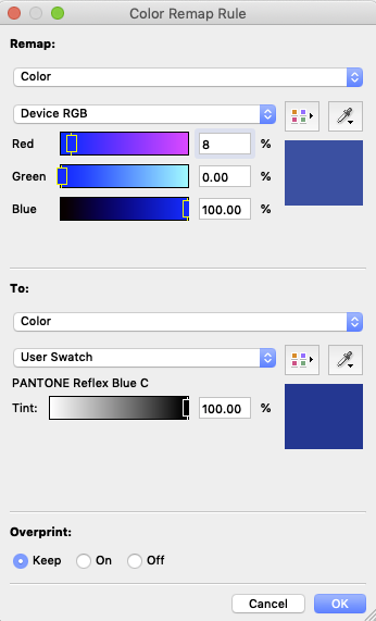

Hello Everyone,
I'm trying to trying to convert a RGB colour to a spot colour in switch but when I look through the pitstop action list I can remap the colour to another colour or I can convert the spot colour to another colour but I can't see how I convert a colour to a spot colour. Any suggestions?

you can try selecting the RGB element by colour then remap colour
Remap colour.png (36.18 KiB) Viewed 40539 times
Malcolm

Hi Malcolm,
Thanks for your reply. When I do these steps I don't seem to get a choice in which Pantone colour I would like, any suggestions?

Not sure why, maybe a PitStop Version issue.
What version are you on please?

That looks like it's from PitStop Server.
You don't have access to the Color Picker and Grab options in PitStop Server as the color databases aren't present.
The way to do this would be in PitStop Pro and then to import the Action List into Server either as an Action List or an Action List embedded in a Preflight Profile.

Ok, thanks guys I'll try to import it as an action list and let you know how it goes.

Importing as an action list worked perfectly, cheers!
