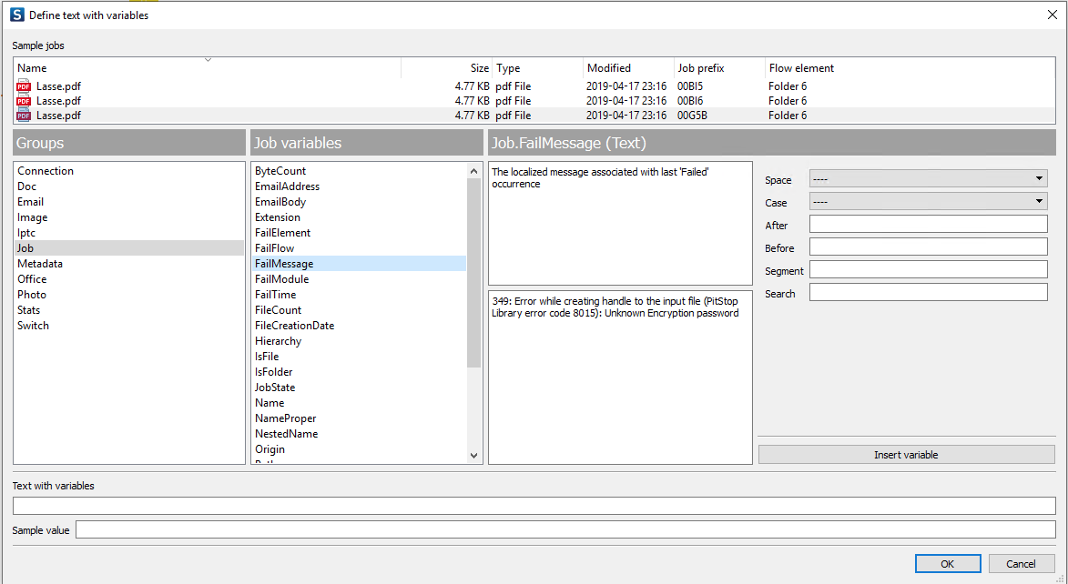

Arthur, it looks like you can route the files from the Problem jobs folder by simply doing an Include these jobs - Define condition with variables and then set Contition to Job > FailMessage - Contains - Unknown Encryption password ;)
Skärmavbild 2019-04-23 kl. 16.46.31.png (73.67 KiB) Viewed 21987 times

Hi Lasse;
I know it can be done this way.
But again this is something I would like to avoid, as our flows are basically designed the way that there is no routing out of ProblemJobs. So when a file lands there its definite and no routing out is allowed.
But I guess this may be inevitable here :-/
