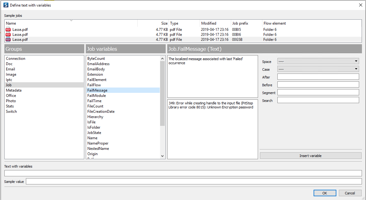

Arthur, it looks like you can route the files from the Problem jobs folder by simply doing an Include these jobs - Define condition with variables and then set Contition to Job > FailMessage - Contains - Unknown Encryption password ;)
Skärmavbild 2019-04-23 kl. 16.46.31.png (73.67 KiB) Viewed 21992 times
