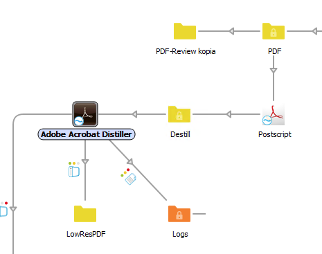

I have a flow that at one stage of the flow creates a low res pdf. When we had Switch running on a Mac this worked perfectly, however since we moved to Windows the destiller will fail with this error in messages: "Error while distilling file 'C:/Users/Admin/AppData/Roaming/Enfocus/Switch Server/backing/Indigo Submit/automanaged/Destill/_00MZ4_P167241_STIHL_NORRASKOG_ERBJUDANDE_A4 (002)_Korrektur.ps'; check Distiller log output for more details". There is no file places in the Logs folder going from the Acrobat Distiller.
If I drag the postscript file to Acrobat Distiller it will distill just fine.
Any Ideas what might cause this problem?

Run PitStop server instead for this.
There is an Action List that comes with PitStop that resamples images in a PDF, it is called "Resample for Web" and is found in the image folder. Change the settings to what you want.

Thanks Jan.
Looks like it's working nicely.

Hi LasseThid,
I met the same issue, there is a fix, due to an Acrobat Update.
Read this article to handle correctly Acrobat Distiller :
https://www.enfocus.com/en/support/know ... 000Xn8RAAS
Ask at Enfocus for the modified Distiller.vbs, or send me a private message, I will send you a Download Link.
