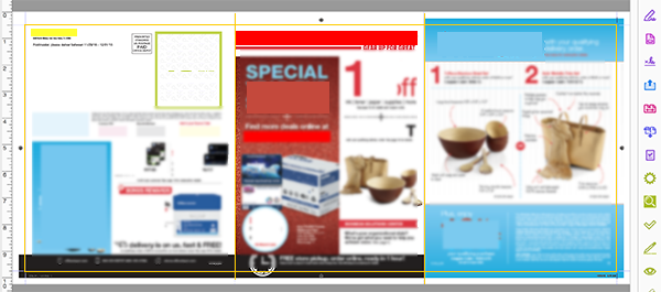

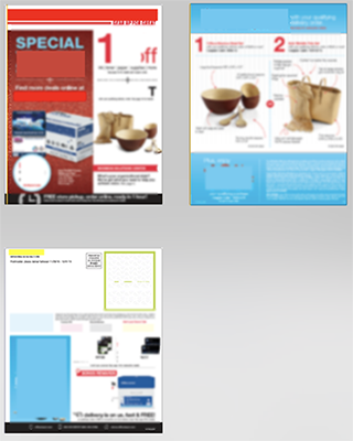

I'm using with PitstopPro 2019 & Acrobat DC for Mac. I need to crop a gatefold cover in 3 different panels. In Acrobat I can select the area & use the crop tool repeating the same action 3 times for each panel but the ES system I'm using is not honoring these changes. I would like to know if I can do this in Pitstop.

Interesting one.
I guess you have a front and a back.
What are the three page measurements, I guess it's something like 210mm, 210mm, 209mm?

BTW, it's definitely doable in PitStop 2019.
The new Split Action List really helps.
If you give me the page dimensions I can have a play.
Do you need Bleed on the split pages?

The bleed needs to be cropped too. Page measurements are: left panel 7.25" (184.15mm), center 7.375" (187.325mm) & right panel 7.625" (193.675mm) (right panel folds in).

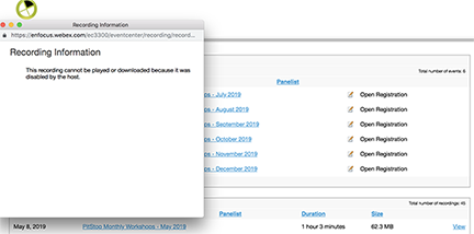

I really need to watch the webinar but & getting a message:
This recording cannot be played or downloaded because it was disabled by the host.

I was never able to watch this. Can you send me the link? In the eLearning, I'm still getting the message This recording cannot be played or downloaded because it was disabled by the host.
