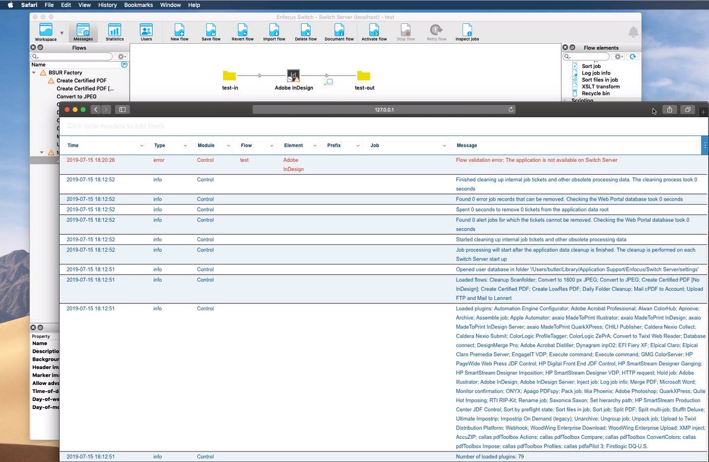

Today we got a problem with Adobe InDesign 2017 on our Enfocus Switch 17 update 1 server: "Flow validation error: The application is not available on Switch Server”. Thought it was our present configuration Mac Pro (2009), MacOS El Capitan 10.11.6 and Adobe InDesign 2017.
So got new iMac. Installed MacOS Mojave. Installed Enfocus Switch 2018 Update 3. Adobe InDesign 2019, (14.0.2). Transferred Switch Licenses, installed configurators. But I'm getting still the same error with validation: "Flow validation error: The application is not available on Switch Server”. Downgraded Adobe InDesign to 2018 13.1.1. But that didn't help.
Anybody have an idea what's wrong?

Right click on the InDesign configurator in the list and chose "Set path to application..." and then select your InDesign so tha tSwitch knows which InDesign it should use.

Also Switch doesn't likes multiple versions of any CS app either.
Has to be one only.
