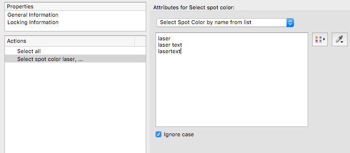

Terkelsen
Posts: 346
Re: Select spot color by regular expression
Post by Terkelsen »
If you like to play around with regular expressions, thats fine, but there is already a standard action in PitStop that will let you select spot colours from a list and it can even be case insensitive :-)
Skærmbillede 2020-04-16 kl. 15.33.32.png (39.77 KiB) Viewed 8870 times
