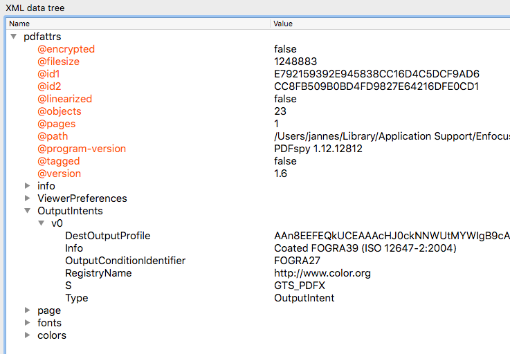

Acrobat XMP-data that is visible in Switch doesn't contain the Output Intent.
Best way is to use Apago PDF Spy, it will list the output intent in a Dataset
Screenshot 2019-07-18 20.18.51.png (91.29 KiB) Viewed 6373 times
