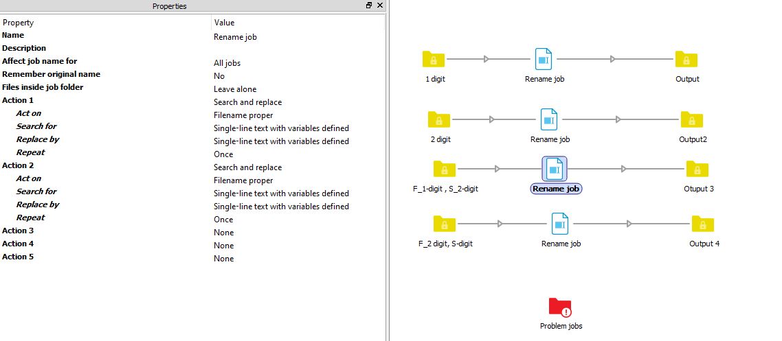

3. I found that I can work fine if I use 2 different Rename Job Element.
( In my screen dump, Input folder "1 digit", "2 digit")
4. However, if I put them together as Action 1 for 1 digit, Action 2 for 2 digit, or vice versa. The jobs will go to problem job with error "Dynamic property "SearchFor1 (or 2)" has invalid value."
(In my screen dump, Input folder is "F_1-digit, S_2-digit" and "F_2 digit, S-digit")
So I would like to see any mistakes being made.
Thank you in advance!
1-Flow diagram.JPG (58.01 KiB) Viewed 5494 times

You must understand that Action 1 is carried out before Action 2. This means that Action 1 will change the name of "B412344_26.pdf" to "B412344_p006.pdf. When Action 2 is run, the first character after the underscore is no longer a digit (it's "p") and Action 2 will do nothing:
I'm not an expert in RegEx but you will need to test for the number of digits after the underscore before carrying out the Action.
