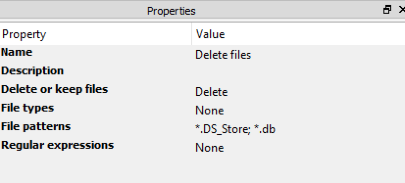

Can this folder delete files that are not visible inside Switch (hidden mac files)?
LasseThid
Posts: 365
Location: Molndal, Sweden
Re: How can I delete Mac OS hidden files in Switch on Windows?
Post by LasseThid »
Yes it can!!!
I use it to get rid of the ._DS_Store files using these settings.
In your case just set it up to delete ._*.*
