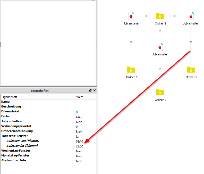

This may or may not be what you're looking for. If you have an input folder with 3 outbound connections, each with a Hold Job attached to it, you can set a time-of-day condition on each hold (you set that in the outbound connection). Then each one is attached to the appropriate workflow.

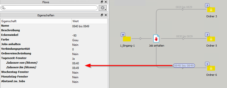

Post by senghaas »
Hi Jslater!
thank you for this simple but functional tip! It works perfectly!
See Screenshot attached.

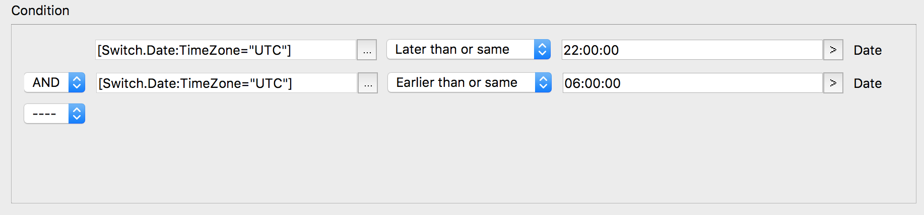

You could try to set up conditions on each connection out of the Input folder on when a file can go through that connection.
Screenshot 2019-09-10 08.48.10.png (61.78 KiB) Viewed 12025 times

senghaas
Posts: 22
Joined: Tue Dec 06, 2016 1:40 pm
Location: Heilbronn
Re: Input folder with time-controlled outputs
Post by senghaas »
Thank you Jan Suhr for this excellent proposal. I will try thif of course.
In the meantime, however, I did another successful test.
Hi, JSlater,
the idea of a hold job was the right one. The times can now be stored for each output connection and it now works as desired.
Thank you!
