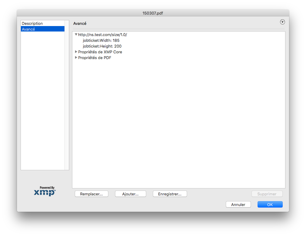

I get an empty metatag "test" in the pdf that contains width and Height. But I don't get the values from the XML "PrintWidthTextColor" (185) and "PrintHeightTextColor" (200). But I can see the XML value as a sample value in "Update XMP" when I select "New value".

There is also something strange into the XMP update : XMP path was not good. I fix it into the new flow.
The better way to setup is to put a pdf and xml file into the flow and stop it before the XMP update. So you can work directly into sample file.
This is the result into the PDF :
Capture d’écran 2019-10-11 à 16.28.14.png (61.99 KiB) Viewed 13146 times
Tadaaaaa :lol:
