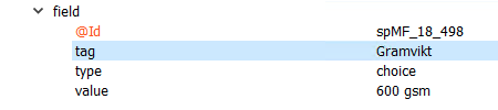

For added readability and flexibility you could replace "/field-list/field[6]/value" with "//field[tag='Manager']/value" or whatever the field tag is that you want to use.
It's much easier to understand what //field[tag='Gramvikt']/value is than what /field-list/field[2]/field-list/field[1]/field-list/field/field-list/field/value is... :lol:
Also, in case you make changes to your submit point in the future "/field-list/field[6]/value" may give you incorrect data while "//field[tag='Manager']/value" will always give you the same data... :!:
