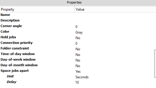

Use Hold jobs configurator but instead of setting it up, setup outgoing connection.
In the bottom of the properties you will find "Space jobs apart" option.
Set it to 10 seconds, or whatever and off you go.
Screen Shot 2019-10-10 at 4.36.05 PM.png (21.03 KiB) Viewed 5449 times
