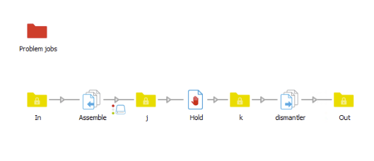

Hi Lasse
Maybe something like the flow in the link?
https://www.dropbox.com/s/nx3xugrarl8yg ... sflow?dl=0
Screenshot 2019-11-03 09.47.23.png (18.3 KiB) Viewed 13643 times

Yeah, I have that setup in a different flow, but as the ordered amount for each products is different, I would then have to make as many copies of the page for each product before assembling the pdf and then splitting it, which means I could end up with about 1000 pages 700x1000 mm in the pdf before splitting it and I would have 250 impositions with a run length of one copy instead of fewer impositions with longer run lengths, ie. 50 impositions with a run length of five copies if the customer order 200 products, five copies of each... :D

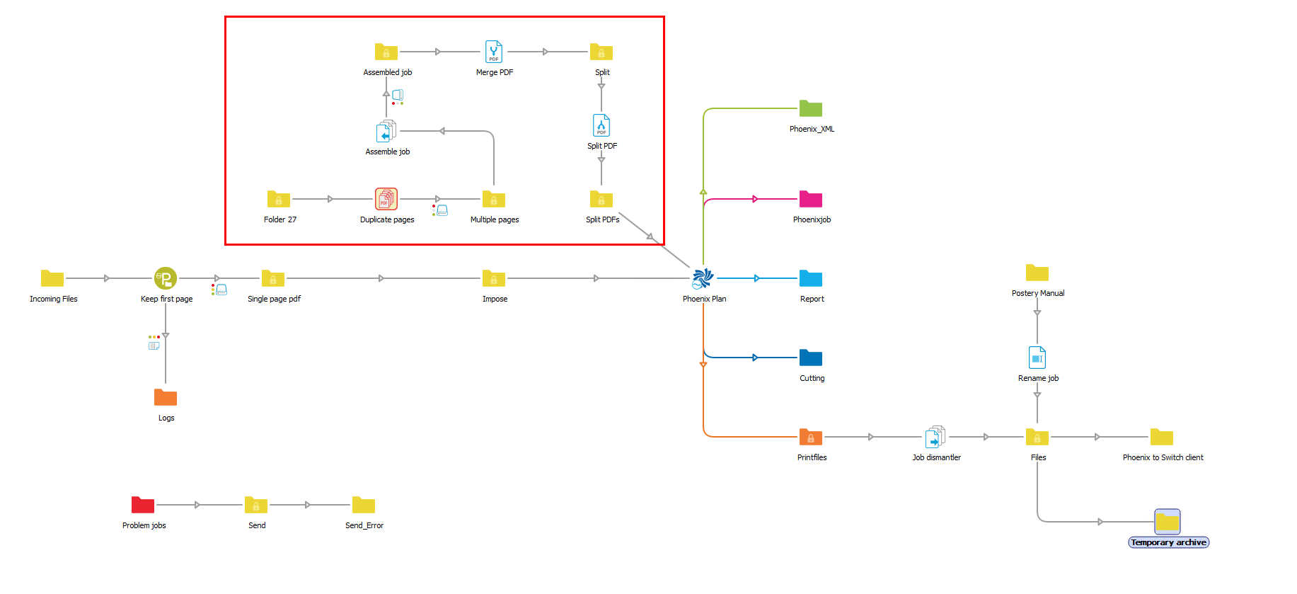

Anywho, here are two screenshot of the two flows I have.
The first flow converts the csv file to xml files and then injects a dummy pdf, in order for my to pick up the xml information. I then rename the job and export the xml to a folder to be picked up by the pdf injected by the dummy pdf and then I rename the files for production and color match them before sending them for impositioning. This part works as it's supposed to.
It's the second flow that's the problem...
Either I need to find a way of releasing 50 files every ten to fifteen minutes, which keeps the resulting impositions to a minimum and hence the number of print files or I implement the part in the red box which means more impositions and more files for the print operators or I accept that I have to edit the incoming csv files so they contain no more than 50 products or bite the bullit and upgrade the license... :lol:
By the way, I'm sure there's a better way to do what I want to achieve with this flow, but this is the only way I could think of doing it... 8-)
First flow.png (148.98 KiB) Viewed 13605 times
Second flow.png (60.36 KiB) Viewed 13605 times
