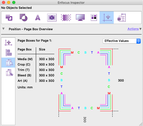

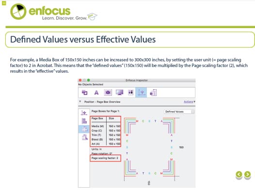

Re: Page Scaling
Andrew was faster. Here my answer:
When you change the page scaling, you attach this property to your document, but it is not applied.
You can see the final result in the "effective values", see screenshot below.
You will find a default action called “Apply Page Scaling Factor” to apply the scaling factor.
Your document will be modified to 300x300 in this case, with a page scaling factor of 1.
Apply Page Scaling Factor description:
The page scaling factor will be removed and the page size will be multiplied by its scaling factor.
The page scaling factor will not be applied when the page size (or objects on the edge of the page) would exceed the maximum page size supported by Adobe Acrobat.

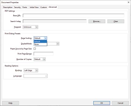

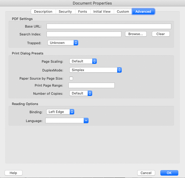

Re: Page Scaling
If it doesn't need to be applied and the RIP does it for you then what is it doing there?
I work in a grand format environment and work with reduced file size all the time. To be able to "tag" an image with a scaling component would be desireable.
What I don't understand is PitStop is TELLING me that you can assign a scaling component in Acrobat and yet there is no place to enter a scaling component in Acrobat. In Document Properties/Advanced/Page Scaling the only option are "Default" and "None". Where does PitStop grab this information from? Where can I enter it?

Re: Page Scaling
I think you are getting confused with Acrobat and the PDF specification.
What it's saying is that Acrobat supports Page Scaling, what that means is that if a PDF has page scaling in it, That version of Acrobat will recognise it and show you the correct size. Previous versions of Acrobat will show you the Defined Values, so not the size with page scaling.
The page scaling option (user unit) was added to the PDF 1.7 specification, so earlier PDF versions did not have that function.
Acrobat does not have an option for everything in a PDF, if it did PitStop would not be needed.
To enter a page scaling value into a PDF you can use a PitStop Action list. I've attached one that changes the Scaling Value to 2.
You'll need to import this into your local PitStop Action Lists.
Once you've done that just run it on a page, and you can see if it's been applied in the PitStop Inspector.
To change the value, double click the Action List to open it, and change the value and close.
