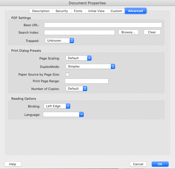

I think it's part of the properties and/or print options
Screenshot 2020-03-19 at 08.46.33.png (185.16 KiB) Viewed 21647 times
What are you trying achieve?
Not sure many people use this field in production.

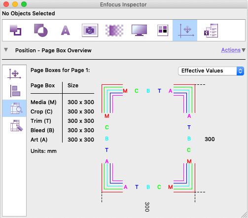

Andrew was faster. Here my answer:
When you change the page scaling, you attach this property to your document, but it is not applied.
You can see the final result in the "effective values", see screenshot below.
You will find a default action called “Apply Page Scaling Factor” to apply the scaling factor.
Your document will be modified to 300x300 in this case, with a page scaling factor of 1.
Apply Page Scaling Factor description:
The page scaling factor will be removed and the page size will be multiplied by its scaling factor.
The page scaling factor will not be applied when the page size (or objects on the edge of the page) would exceed the maximum page size supported by Adobe Acrobat.
Effective values.png (50.09 KiB) Viewed 21645 times

What I don't understand is PitStop is TELLING me that you can assign a scaling component in Acrobat and yet there is no place to enter a scaling component in Acrobat. In Document Properties/Advanced/Page Scaling the only option are "Default" and "None". Where does PitStop grab this information from? Where can I enter it?
