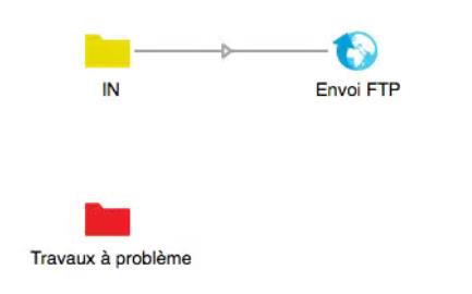

I need to send PDF files to a specific sFTP server.

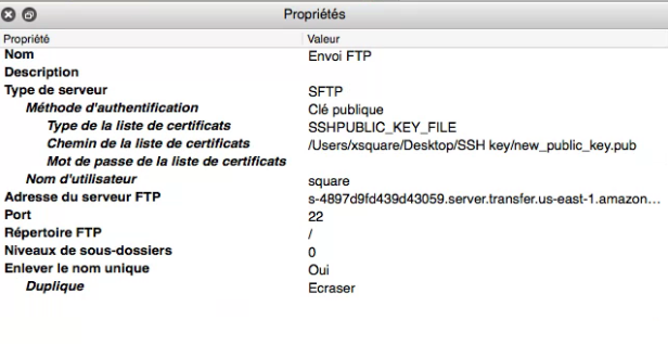

I created this Switch flux (see the first attached picture), with an IN folder where everyone can deposit PDF files, and then the Flux element (FTP send) automatically sends these files to the server. This FT send element is set up (I indicated: it was a sFTP, I entered the public key, login url, username, port and other information, see the second attached picture).
This information is identical to that used to connect to the server via Filezilla. And via Filezilla, the connection to the server works perfectly.
But this flux doesn't work, the error comes from the "FTP send" element that says "Impossible connection to the server."

The second picture is here
