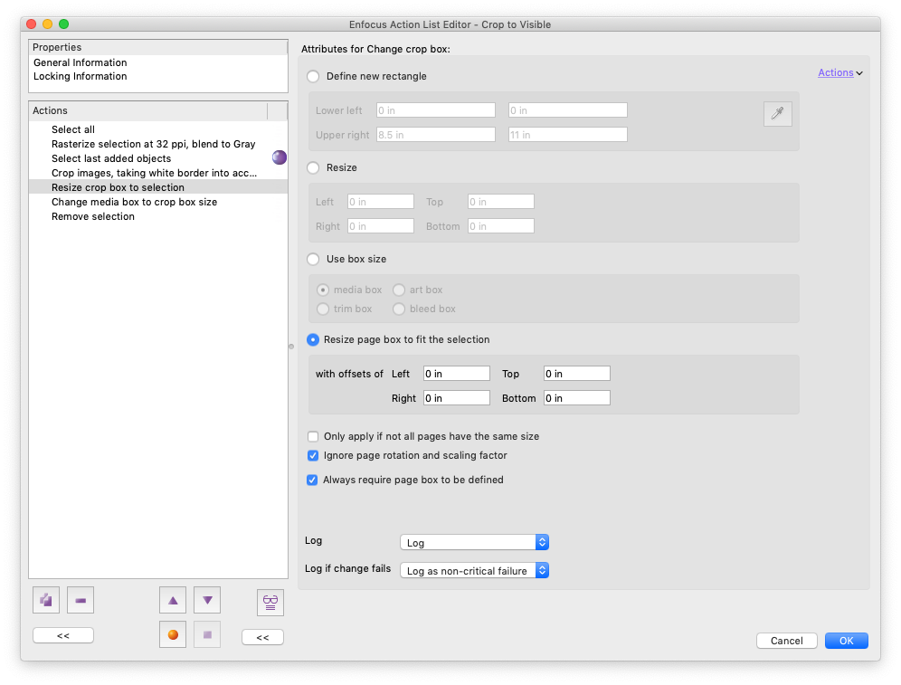

Maybe first to explain how the crop to visible works.
Firstly it selects everything you want to crop to, in this case everything (all)
Then it makes a grayscale image (32dpi) of that content as a copy
Then it crops the white edge pixels away from that image
The the Crop box is resized to the bounding box of that image.
Then the Media box is resized to the size of that Crop box.
Then the grayscale image used for all of this is deleted.

Well that was fun. I think I have an approach that will work.
What I did was I added a small rectangle at the centre bottom of the page in a spot color called 'Placeholder'.
This means that when the image is created for defining the cropped area, the bounding box included the bottom of the page (based on the Media box).
After the cropping was finished I simply deleted that spot color.
Give it a try and let me know how you get on. I made this in PitStop 2020, but it should work in older versions as well.
