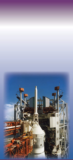

I uploaded a screenshot, it wouldn't allow me to upload a pdf. Anyways we receive various files from customers, it could be a pdf, with a gradient that has a CMYK color at one end and the other end is a spot. Then there could be a RGB image with a transparency. We print large format to multiple substrates/printers. I am working on creating a workflow in Switch using Pitstop Actions - with the one unknown.... if the customer supplied file may not be perfect.

Ok, there's a lot going on here and a lot that can be incorrect in the file leading to bad results.
Can you send me a couple of files. andrewb@enfocus.com
What's your ideal workflow?
If you are dealing with multiple large format print engines it could be that you are best to leave the Devices Rip to render these files.
Especially if you have devices with extended ink sets and larger color gamuts.
Possibly the spot color lookup tables might give better results than converting everything to CMYK which would have a smaller color gamut.
