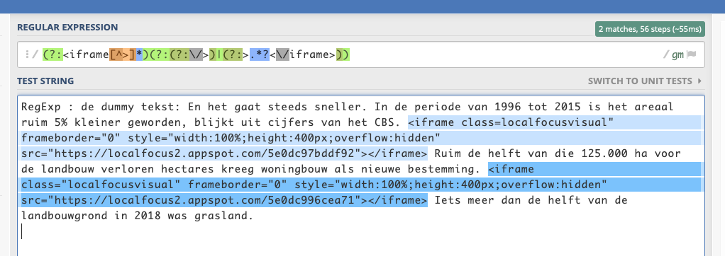

Hello,
I have a problem to replace tekst in a string with a regular expression.
The regular expression works on https://regex101.com (see enclosed picture). I found it on the Internet.
I can't get it to work in my script, it does nothing.
I tried many variations.
dummyTekst = dummyTekst.replace(/(?:<iframe[^>]*)(?:(?:\/>)|(?:>.*?<\/iframe>))/g, "");
Below the tekst to be cleaned example:
En het gaat steeds sneller. In de periode van 1996 tot 2015 is het areaal ruim 5% kleiner geworden, blijkt uit cijfers van het CBS. <iframe class=localfocusvisual" frameborder="0" style="width:100%;height:400px;overflow:hidden" src="https://localfocus2.appspot.com/5e0dc97bddf92"></iframe> Ruim de helft van die 125.000 ha voor de landbouw verloren hectares kreeg woningbouw als nieuwe bestemming. <iframe class="localfocusvisual" frameborder="0" style="width:100%;height:400px;overflow:hidden" src="https://localfocus2.appspot.com/5e0dc996cea71"></iframe> Iets meer dan de helft van de landbouwgrond in 2018 was grasland.
What is wrong with my script? The iframe tags with the text inside has to be removed.
Thanks in advance,
regards,
Guido

Re: RegExp problem, remove iframe
Personally, I would have preferred to use this:
dummyTekst = dummyTekst.replace(/<iframe.+?><\/iframe>/g, "");
But unfortunately, Switch Regular expressions don't support the lazy quantifier (the "+?"), so it doesn't work. You can see what Switch regex supports in the documentation:
https://www.enfocus.com/manuals/UserGui ... sions.html
I have a very ugly solution which works in your test:
dummyTekst = dummyTekst.replace(/<iframe.{3,180}><\/iframe> ?/g, "");
Basically, I assume that the amount of text will always be between 3 and 180 characters. If you can be sure that the text of the iframe will always be more or less the same length, then this can be a workable solution.
