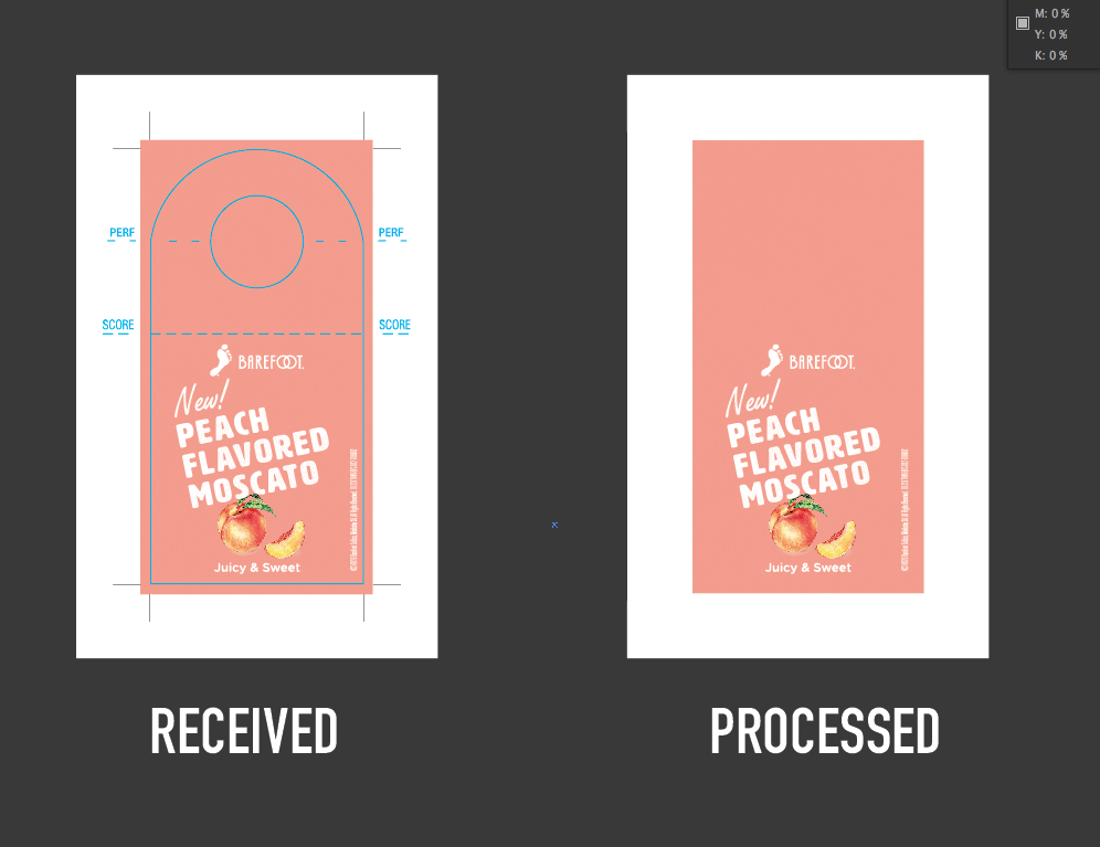

Hello all, I have a client who sends in a file with perf, score and die lines that need to be removed. I havent found the right action list to use as a template. Any suggestions? Thank you all, be safe be healthy.

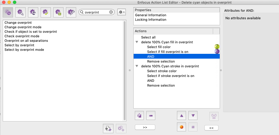

Yes indeed, the order of the actions does matter a lot, and AND OR NOT operators should be placed under the action(s), and can also be combined:
AND explained: https://www.enfocus.com/manuals/Extra/A ... ept/1.html
complete action: https://www.enfocus.com/manuals/Referen ... 87449.html

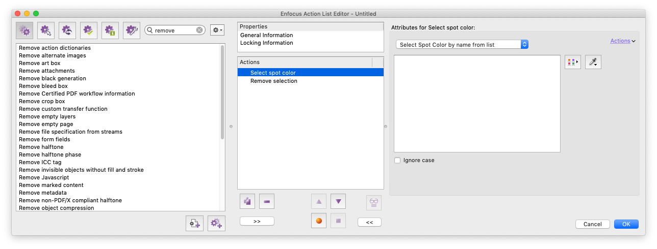

Also, if you choose ”Select Specific Color" 100% Cyan stroke and fill, you expect the objects to have a 100% Cyan fill AND a 100% Cyan stroke. Most of the time it will be stroke OR fill.
I don’t have your pdf document to make some tests, but you should try to find something very unique to those marks. Most of the time it is a custom color, then the "select spot color" Andrew used is the best option.
Maybe it is cyan AND in overprint?
Let’s consider the objects are also in overprint, see my example below.
Also note the green and purple bullets, they help you to understand the effect of AND OR NOT, certainly when you combine them.
