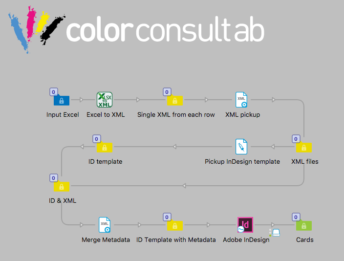

Well you have to split up that CSV into one XML for each row. That single XML is sent to InDesign that creates the PDF from the template and the XML-data. Naming of the files come from data in XML.
There is an app that take CSV and make XML from it
https://www.enfocus.com/en/appstore/product/csv2xml
Here is an example that creates business cards from an Excel file. Something like this is a way do solve your task.

Ahhhhhh, I see! I've really got to re-train my brain to think differently with these Workflows.
I'll add the demo license to our Switch and see how far I can get. Thanks!
