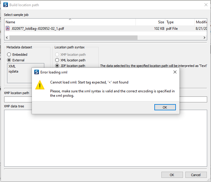

It attaches to the job correctly and I can see in the dataview but when I try to view it I get this error
My JSON seems to be formatted correctly and I'm not sure why Switch is expecting "<"
Has anyone got any idea's?

Switch is only able to read XML (and XML derrivates) as dataset. Datasets from other formats are "just" a way to attach a file to a job, you can't read from it.
There are some node js packages to convert json to xml, I think it is best if you use one of them and then store an XML dataset.
Alternatively, there are also apps to convert json to xml.

I also realized that I have set the datasetmodel set to JDF rather than JSON which didn't help my cause. I will convert to XML just try to take the easy way out.
