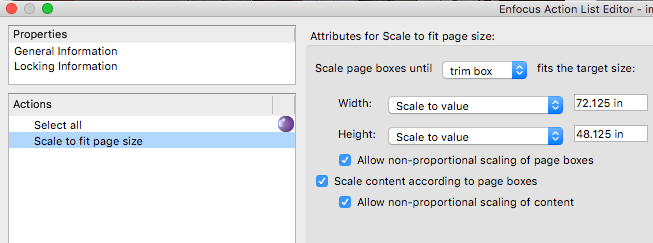

Posts: 1189
Re: Is there way to have Switch place a file in Indesign?
The action that will give you that behavior is: Scale to fit page size. With the settings in the attached screenshot you should get what you now do via Indesign.
Screen Shot 2020-09-24 at 18.04.24.png (43.68 KiB) Viewed 35647 times
The width and height values will probably have to be variable.
Let me also reiterate my remark that using the Add bleed action may be a better fit.
