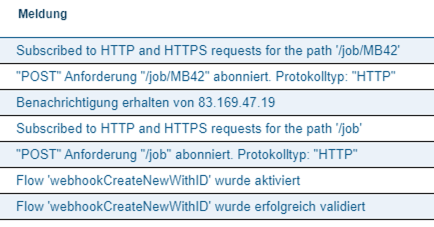

Since the Topic of this post is Switch WebHooks in general ;) I have some further questions.
A different scenario now. I "POST" the JSON {"id":"MB42"} to my WebHook "http://myIP:51080/jobs" in Switch.
Is there a way of dynamically creating new webhooks with the id as path like in this case "http://myIP:51080/jobs/MB42"?
Example code (most of it straight from the docs):
function webhookTriggered(s : Switch, r : WebhookRequest) {
    if (r == null) { // Not a real request, but first initialization call at the moment flow is activated -> subscribe
        try {
            s.webhookSubscribe(WebhookRequest.POST, "/job","HTTP"  );
        catch(e) {
            s.log(3, "Failed to subscribe to the request: %1", String( e ));
            return;
       s.log(1, "Subscribed to HTTP and HTTPS requests for the path '/job'" );
        return;
	s.log(1, "Received notification from %1", r.remoteAddress);
	var newJob = s.createNewJob();
	var id = JSON.parse(r.getBody().toString("UTF-8"))['id'];
	id = String( id );
	[b]// AT THIS POINT I WANT TO SUBSCRIBE A NEW WEBHOOK WITH THE ID IN ITS PATH LIKE /job/42... but how?[/b]
	try {
            s.webhookSubscribe(WebhookRequest.POST, "/job/"+id,"HTTP"  );
        catch(e) {
            return;
       s.log(1, "Subscribed to HTTP and HTTPS requests for the path '/job/"+id+"'" );
        return;
   newJob.sendToSingle(r.content, "createWebhookWithID.json");
The messages from my test script.(read from bottom to the top)
Bildschirmfoto 2020-09-28 um 16.09.36.png (61.37 KiB) Viewed 44571 times
The first path "/job" is subscribed and the second one with "/job/MB42" but if I now try to POST another json on that new webhook ("/job/MB42) nothing happens.
So how can I continue with the second WebHook do I need a second WebHook Triggered function?
