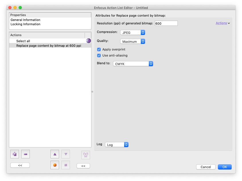

If you just want to convert all the page content to an image you can also try the Action 'Replace page content by bitmap'
Screen Shot 2020-09-29 at 5.56.22 PM.png (90.03 KiB) Viewed 10629 times

Thank you, both solutions work. :)
However, after applying the Pitstop action, the image is slightly blander than the original.
Is this a profile problem in the color management in your opinion ?
Thank you.

It's difficult to see from the screenshot, what's the input/output colorspace?

CMYK for both

by abailescollins
ahh ok
Is it always the same type of input/output profile?
At the moment you have ISO Coated v2 as the input and output profile in the color management options.
Using a devicelink profile before converting to an image might also be worth a try to see the result.
