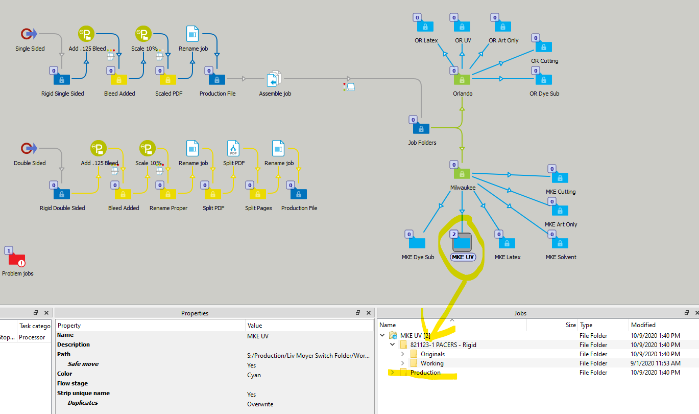

Here’s what I would like to do. Once the file has been approved in my first flow. It then comes into this flow to create the “Production file”. I assemble it to create a folder called Production, I would like then it to “find” the Job Folder that was created in another flow. But I want it to place inside the job folder, so I would have:
111111-1 Job Folder
Originals Folder
Production Folder
Working Folder
I have tried using the Inject Wildcard and I just can’t get it to work.
Any advice would be greatly appreciated.

Have you tried Set Hierarchy and Archive Hierarchy. It should solve it for you.
