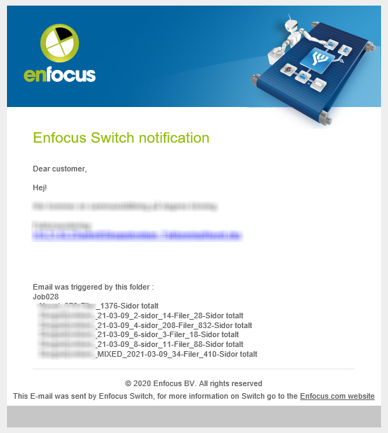

Then the files are collected so that all 2-pages, 4-pages, etc. end up in the same file. Then an email is sent with a summary of how many of each variant. Everything works well so far. The problem is when I want to use my own "HTML Template" for mail send
If I send the email as plain text, it goes well. If I send as HTML and use a "Built-in" template, it works fine, but if I use my own template, I do not get the text. Which variable should I use to trigger my info? Or where can I find the "Built-in" template and can edit it? Please see attached photos. Thanks in advance!

In your own HTML-template you insert Switch variables with the information you want to display in the email.

jan_suhr wrote: Thu Mar 11, 2021 6:00 pm In your own HTML-template you insert Switch variables with the information you want to display in the email.
Yes, I agree. The problem is that I do not know what "Switch variable" I should use. I have tried several different but without success. (see attached file) If I were to access the "built.-in" template, can I see what it looks like or do you know which variable (s) I should choose? Thanks in advance!

Pantone485 wrote: Fri Mar 12, 2021 3:28 pm
In your html you need to insert your switch variable inbetween <span> </span>
example:
<p>Hello <span>[Job.UserFullName]</span></p>
Posts: 1189
Re: How to set text file contents as email body
Putting the Switch variable in between a <span> construction is not necessary. It can be anywhere in the HTML as long as you take care to keep the HTML structure valid after the value of the variable is inserted. Here is an example that uses two Switch variables:
  • the name of the job: [Job.Name]
  • the link to the document on the PDF Review Server:[ Job.PrivateData:Key="com.enfocus.PDFReviewModule.URL"]
The example displays only the name of the job in some kind of blue to indicate that it is a link. The link itself is not displayed but clicking on the name of the job will jump to it:
<a href="[Job.PrivateData:Key="com.enfocus.PDFReviewModule.URL"]" style="color:#337ab7; text-decoration: none;"><font face="Arial, Helvetica, sans-serif" color="#337ab7" size="2" style="font-size:16px;">[Job.Name]</font></a>
