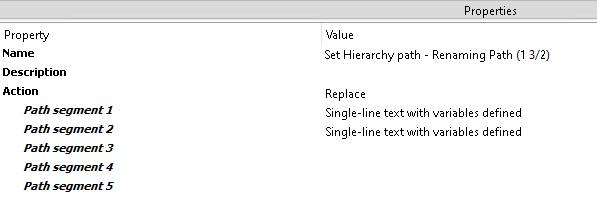

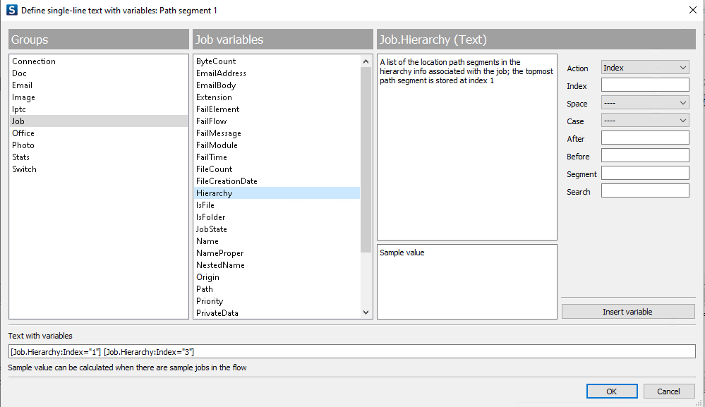

I'm not an expert, but I built a flow with similar needs to yours. I am attaching some screenshots. the element to use is "Set hierachy path". As you will see, it allows you to extract the various parts of the file path, to recombine them as you need. When you select the element in properties you set Action (there are various, i set "Replace") and set the value of path segment with "Single line text with variables defined".

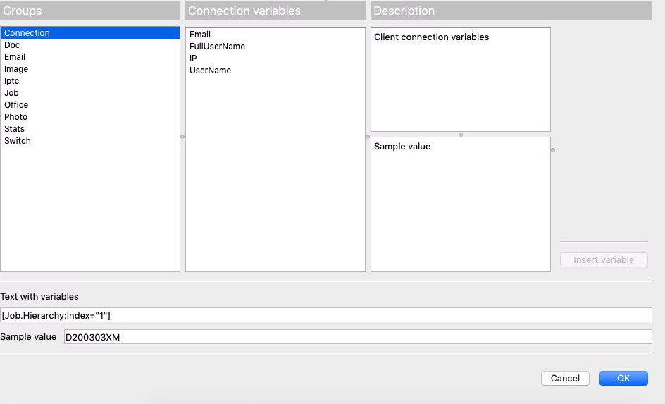

I setup a Set Hierarchy Path element with the following path segments
Path Segment 1 - This is creating the folder name as I expected it to (D200303XM- the name of the input folder)

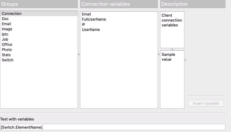

What is happening is it is creating the folder "D200303XM" and then just placing the gif images in that loose rather than creating the subfolder "GIF" first... what am I missing??

For the Path Segment 2 you need [Job.Extension] (or [Job.Extension:Case="upper"] if you want to ensure uppercase names GIF/PNG/JPG).
[Switch.ElementName] gives you the name of the current flow element, e.g. "Set Hierarchy Path" or "Folder 123".
