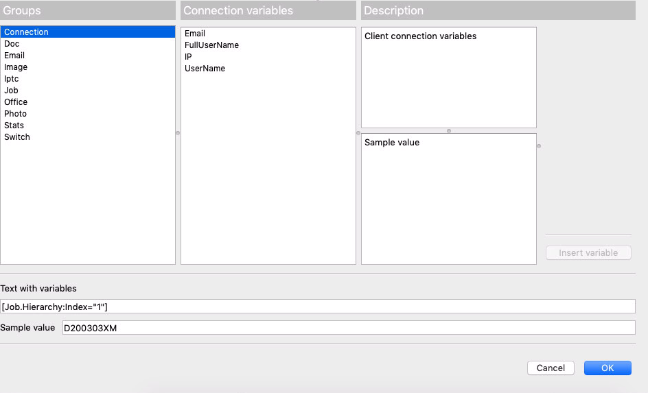

I setup a Set Hierarchy Path element with the following path segments
Path Segment 1 - This is creating the folder name as I expected it to (D200303XM- the name of the input folder)

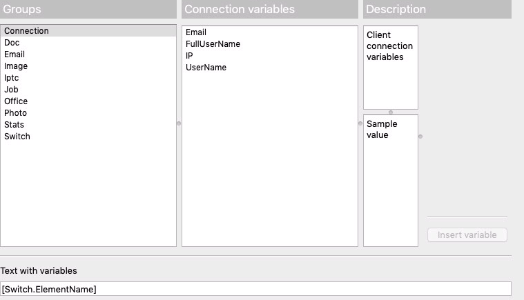

Path Segment 2 - I thought this would create the next sub folder based on the element name
Screen Shot 2021-01-19 at 3.25.59 PM.png (77.98 KiB) Viewed 10652 times
What is happening is it is creating the folder "D200303XM" and then just placing the gif images in that loose rather than creating the subfolder "GIF" first... what am I missing??

For the Path Segment 2 you need [Job.Extension] (or [Job.Extension:Case="upper"] if you want to ensure uppercase names GIF/PNG/JPG).
[Switch.ElementName] gives you the name of the current flow element, e.g. "Set Hierarchy Path" or "Folder 123".
