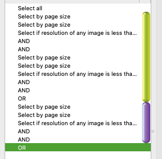

Hi
You should be able to do it in an action
Roughly as below, not tested but I've done similar.
1st page size is larger than, 2nd smaller than.
Malcolm
Screenshot 2021-03-10 at 11.01.32.png (22.83 KiB) Viewed 7137 times

Another and probably more performant option is to setup the preflight profile to use a variable and let Switch set its value according to the page size. However, if you may have different page sizes in the document (that might fall into those different categories), then you might be better off using the action list Malcolm mentioned than e.g. splitting the document in Switch and preflighting pages separately...

Another suggestion is to use Restrictions in a Preflight Profile. You add the different page size selections as individual restricting action list in the Restrictions part of the profile. Then, in the Image section of the profile (or in any other section for that matter), you can define different settings for the different restrictions. In other words, you get multiple profiles within one profile. It may sound confusing, but when you try it out you will see it is pretty straightforward.
