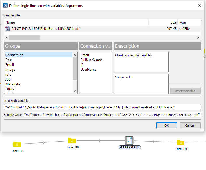

I am experiencing an annoying issue with PDFTK server, which seems it does not output PDFs to a folder of choice, unless I go Scan Folders Now manually from the right-click in Switch.
Until then, no PDF is produced.....
Anyone had anything like that ??
The command is fairly simple:
"%1" output "final_location\folder\_[Job.UniqueNamePrefix]_[Job.Name]"
Help anyone please ?? :)
PDFTK Issue.PNG (28.99 KiB) Viewed 8119 times

You should use "%2" with output "File at Path"
Re: PDFTK does not output PDFs in Switch unless manual folder scan is invoked
Posted: Mon Apr 12, 2021 2:40 pm
by jan_suhr
And also set the Output property to "File at path" it is by default None and will there fore not output anything

Will check that later. I chose a defined path however as the "%2" never worked for me....

Arthur wrote: Mon Apr 12, 2021 3:06 pm Will check that later. I chose a defined path however as the "%2" never worked for me....
Will report after the changes.
Interesting though....
Sounds like the Output property is set to None

I shall report that the suggested amendments did the job and indeed it works as expected.
Which on the other hand I am finding strange, since we've been using PDFTK in our flows for the last 3 years and it never worked with "%2" for the output, yet it always did with a fixed path, as exampled earlier.
Now on the new machine it works using "%1" output "%2" and file at path and this is the most important bit.
Thank you for your help, as I would probably have my mind fixed on how it used to work for the last couple of years and be going in circles trying to figure it out myself.
