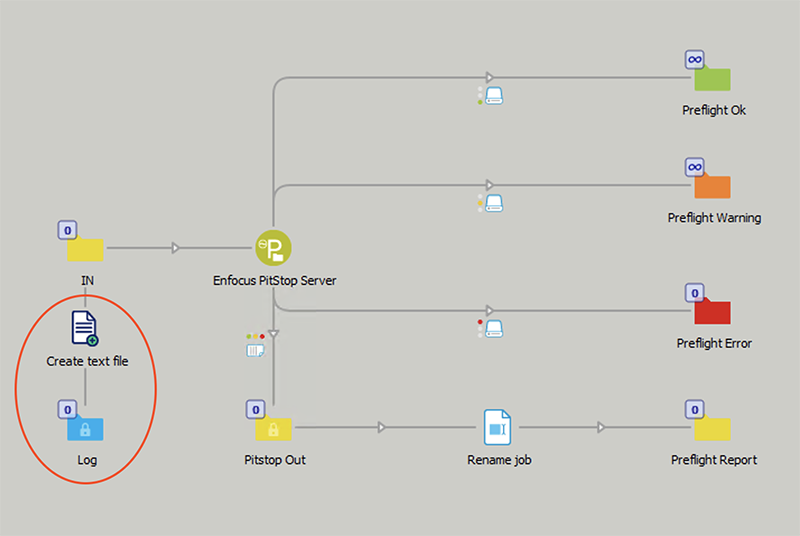

I also vote for the above as a feature request. For now I will just add a connection that writes small textfiles with jobname_timestamp.txt in all my flows.patej wrote: ↑Tue Apr 13, 2021 2:31 pm I wonder if it would be a big thing for Enfocus to include it in the Flow details, too, I'm sure many would find it a useful out-of-the-box feature. Actually, I submitted a feature request last September (ENFFR-2560) asking them to include the modification date and user who modified it, to the Designer's Properties pane and Admin portal so this idea would be a useful addition to thatCurrently, there is only the Created date in the description field if it's left intact, but having a date from 2013 or 2016 isn't that useful...
