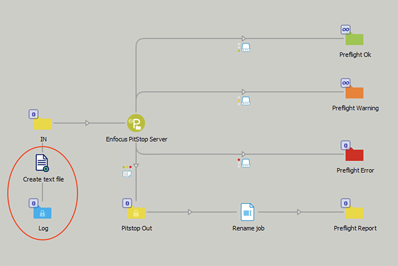

I also vote for the above as a feature request. For now I will just add a connection that writes small textfiles with jobname_timestamp.txt in all my flows.
