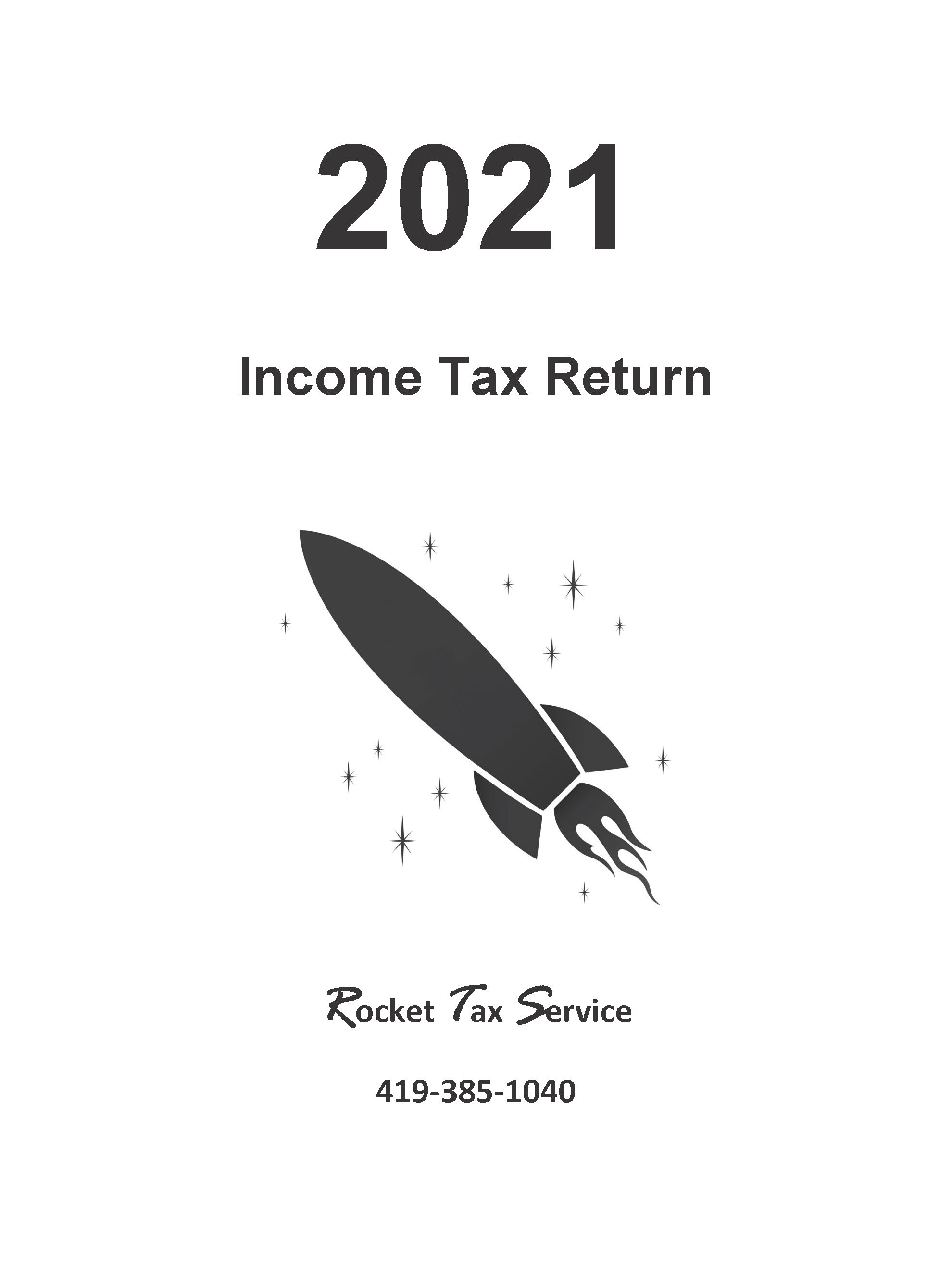

I want to convert a raster image in a pdf file to a pantone color. Not having any luck. I end up with a screened background.
Hope someone can give me a solution... or a step by step process. I am attaching the file I want to convert to reflex blue.
2021 Tax Envelope.jpg (203.67 KiB) Viewed 62893 times
I tried to attach the pdf but was warned it was invalid. Converted it to jpg.

I tried adding a trace path, then filling that with reflex blue. I think it looks good, but I didn't tweak the settings at all. Do you think that would work for you?

Try using a curve on the image first.
Not sure if it's a bitmap or a grayscale image, maybe you can lose the background by blowing it out with a curve first?

The ideas of both jslater and abailescollins could work quite well, depending on your needs. Here's another option.
* If the image is ICC tagged, untag it.
* Turn colour management off.
* Convert the image to Gray.
* Remap (not convert) the image to the spot colour.
* If desired, use a curve or change the contrast to clean up the image.

I solved my problem (although I don't know if I did it efficiently) I exported the raster image to a jpg then traced the raster image in Illustrator and saved as a pdf. During that process no background screen artifact appeared, so I was good to go with replacement and colorization.

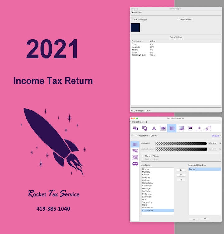

This action works great as intended. I was wondering is there now an extra step to apply a background color. I need all "white" to be a specific color. I would need it to be a 4 color background but also the spot would now be converted to a 4 color (CMYK) value. Thanks in advance.

Well, using the above example to change the black graphics to spot changes the color as intended but you cannot add a background color to it, actually you can but its behind the white background. Please download the "Rocket" file.
I also can draw a square box over it and multiply to get the look but than there is a spot over (Spot not knocked out) my 4C background which is changing the spot color.

If you are playing with Blend Modes, try 'Darken"
I'm assuming that will let the magenta through, and hoping the black will knock out!

I'm guessing there isn't a way for Pitstop to select the white area of a color or grayscale image. Everything I try will just change the "image". I guess I need a photo editor to achieve what I need.Thanks.

Nope, did you try changing 'Multiply' to 'Darken"?

Same result. The spot color is pretty much doing what the "Multiply' is doing. It's just adding the background color below the spot color and not knocking out the spot. The sampled area is from the rocket.
