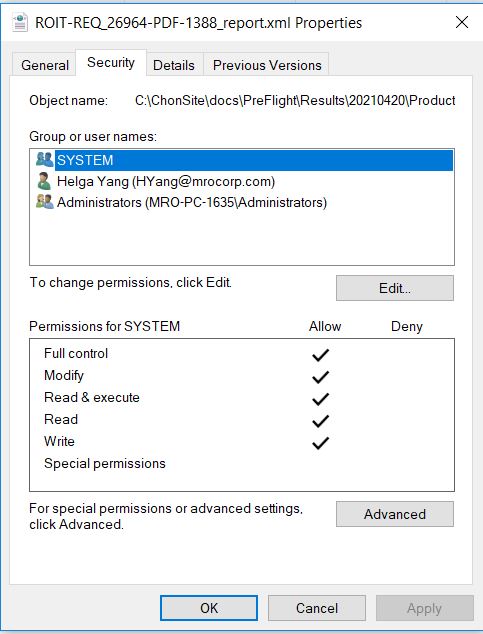

Machine 2 - There seems to be a permission issue with files being written from Switch on this machine. I have results being written out using a combination of Set Hierarchy and Archive Hierarchy. The folder is set so that 'Everyone' has all permissions enabled. When the files are written from Switch, the resulting files only have SYSTEM, local user, and Administrators with all permissions enabled. In fact, no other users have even listed. This becomes an issue downstream because the process used to move the files to a different location does not have permission to the PDF file. Like the other issue, this behavior cannot be reproduced on Machine 1. That kind of leads me to think that there is a configuration setting that I'm missing.

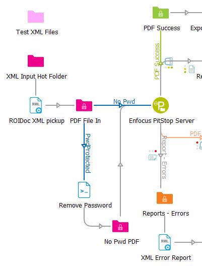

The flow that is causing the folder to disappear is a simple folder and not a hierarchy. See the flow below. The folder in question is 'XML Input Hot Folder'.
I've tried renaming the folder to a very unique name and moving it to a different folder structure to avoid the possibility of another flow using the same folder, but it still disappears when it is empty.

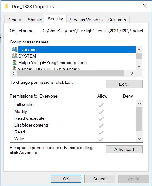

As for the permission issue for Machine 2, it is a local folder. The user which is running Switch is the local user. The interesting thing is that Switch creates the hierarchy, and the folder has the 'Everyone' permission set. However, the files in the folder do not.
Folder permissions:
File Permissions:
